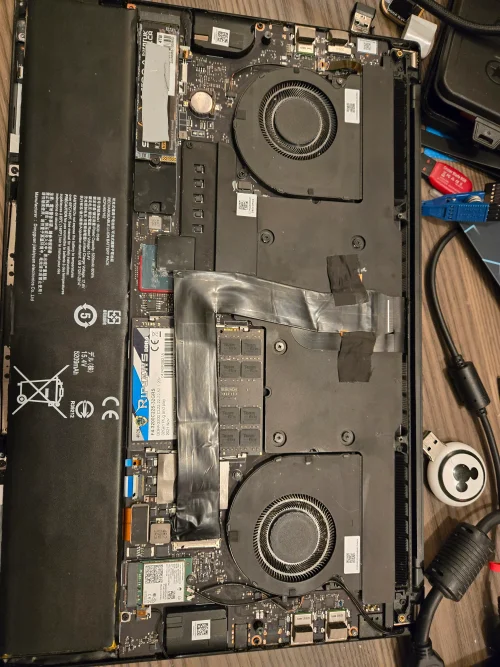

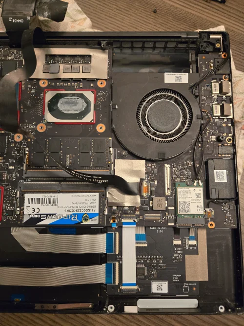

Apologies - Not sure where the info you need is located - The back of the laptop only has the serial number on it - and Im not sure where the board code is located on the MB? I'm attaching a few pics just in case...
Razer Blade 2021 - RZ09-0367ce53 BIOS Needed – 20250415_202058 Razer Blade 2021 - RZ09-0367ce53 BIOS Needed – 20250415_202517

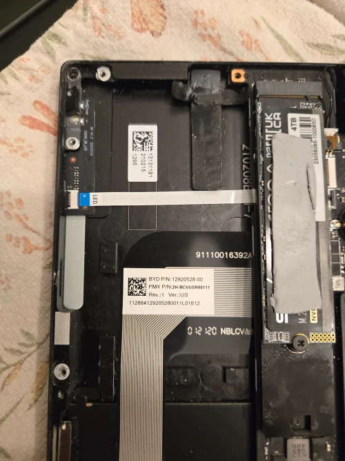

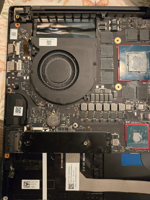

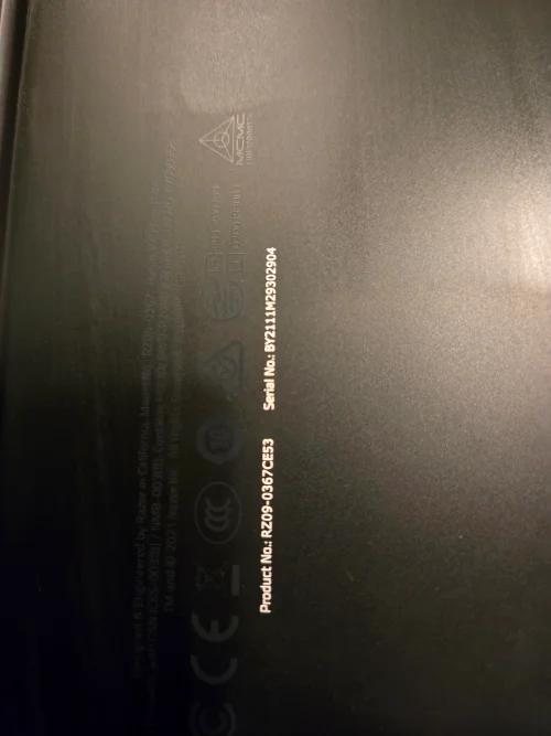

Open the motherboard you'll see board code and also write model number and serial number

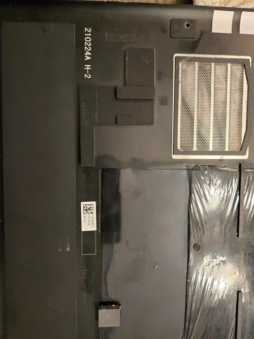

Yeah I looked at the MB and didn't see much - then I remembered under the battery had some information, not sure it's what you need but attached, as is the model and serial from the bottom of the unit. Also a pic from the box that had some ID in it.

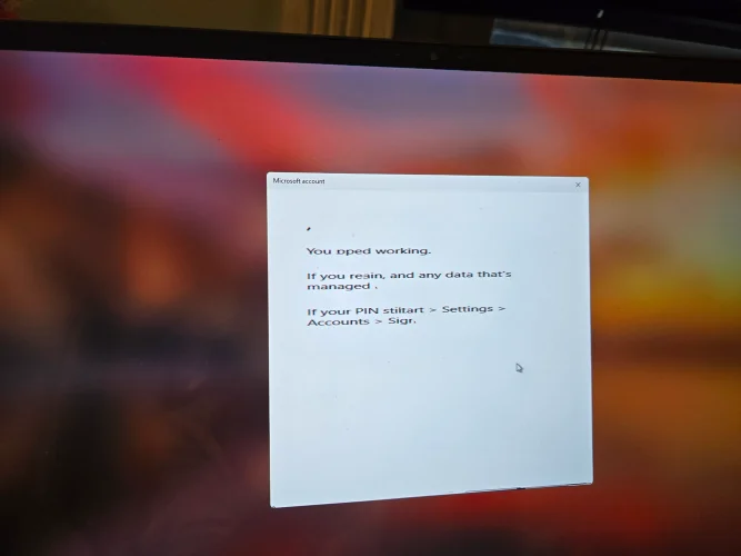

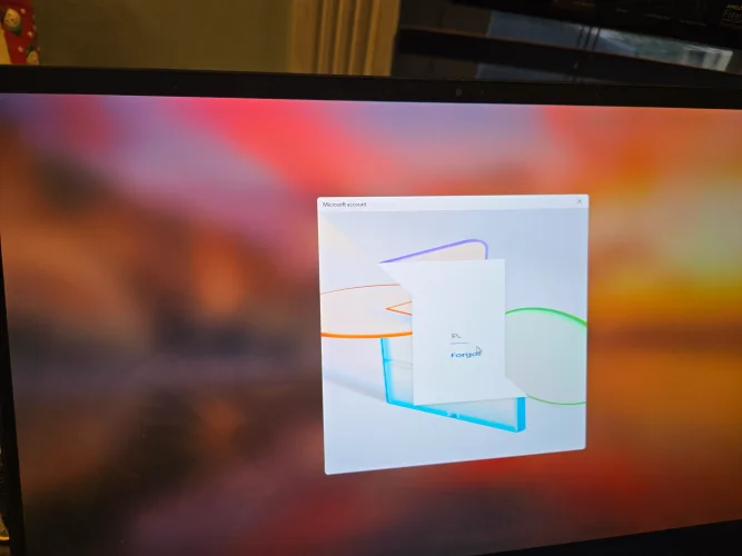

Once in Windows, the login screen appears, and it tries to use Hello - but it fails, with a pin error? (Pin is the backup to hello for me). It claims I havent set a pin, which I did - and it worked before all of this. So, I re-enabled my pin and logged into the desktop. This was not easy at all, which is the next issue - The graphics were acting up during this process - The screen would warp, become un-readable, etc... (See Screenshots attached).

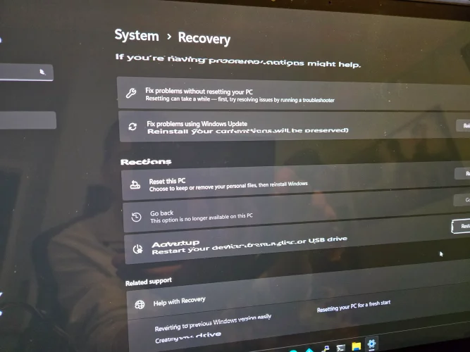

Once I did get to a desktop, it seemed to be working okay - but after a minute or two, that started to have graphic issues as well (See screenshot of settings -> recovery)
So, next - I was going to do a reboot into the BIOS from the advanced recovery, but before I could, it rebooted again. The initial reboot did the same thing as the initial power-up did after flashing. Starts to boot (keyboard lights, fans) - nothing on the screens. Rebooted itself 3 more times, and finally, the LCD came on and it started to boot to the advanced recovery options. It was SLOW to boot, but I finally was able to select reboot to UEFI and the system rebooted again, multiple times in a similar sequence (Power on, keyboard lit, fans ramping up - after 10-15 seconds, reboot and same process). After 4 auto reboots, the BIOS finally came up - I did a restore defaults, just in case - saved and restarted. Of course, same reboot sequence started and when back into Windows, same graphics issues.
Any ideas on these issues? It was all perfect until I flashed the bad BIOS yesterday morning, so the system has no damage / etc... Is it the BIOS?
install fresh Windows and test

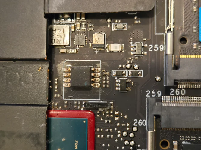

I have the correct chip coming and while I thought i could read and write to the chip, I just tried a write with a verify and it fails - so im guessing the chip is one issue now. I checked the voltage and the chip reads 2.7v, so it's lower than the expected 3.3v.
Attaching a screenshot of the bios chip and the surrounding components
Razer Blade 2021 - RZ09-0367ce53 BIOS Needed – 20250418_151027
I cant see name bios chip.
oh yeah, you won't see it - it's been scratched up too much. I know its a winbond 25Q128JVSQ - I've flashed it a few times over the years.

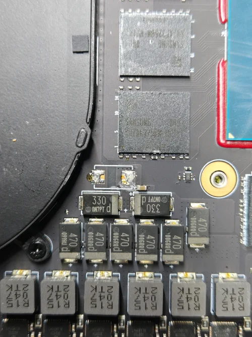

You've been very helpful and I appreciate it! hate to ask a non bios question but im going to, hoping you might know. I've attached a picture, do you happen to know if that missing chip is supposed to be there or if it's blank Intentionally (the 330 inductor... if it is missing)
Yeah look like missing
Its capacitor
Thanks again - I replaced the bios chip and it's programmed, but no luck - yhe machine won't power, so im guessing something was shorted when I shorted the bios itself. :( I'll probably look at it as I get some time, but I need a laptop for sp many things, im going to buy a new one since I won't be able to fix this quick enough
Its capacitor
