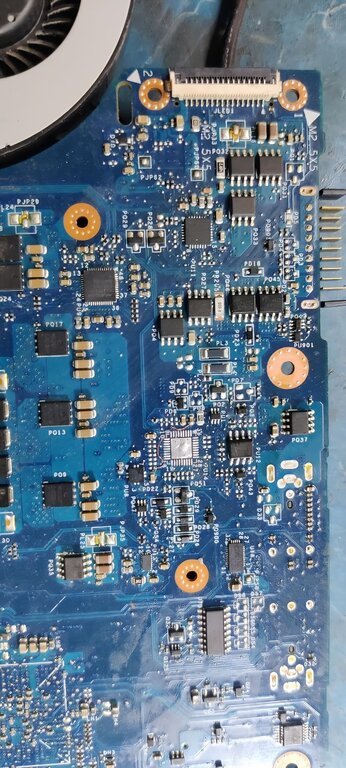

I have done the same as shown in pic but my dc in resistor got burned last time I have put new ic and motherboard gets on now again after 4 5 month same laptop I have received cd ic is burned need tested bypass for la-6562p
there are two board code check and confirm your board
JUST NOW I HAVE SOLVED THE CASE, CONNECT PIN NO. 1 & 20, PIN 7 TO GROUND , JUMPER PIN 34 & 35 ITS WORKING I DONT HAVE BATTERY TO CHARGING OTHERWISE ALL THINGS WORKING FINE. THANKS A LOT FOR YOUR RESPONSE EVERYTIME.
