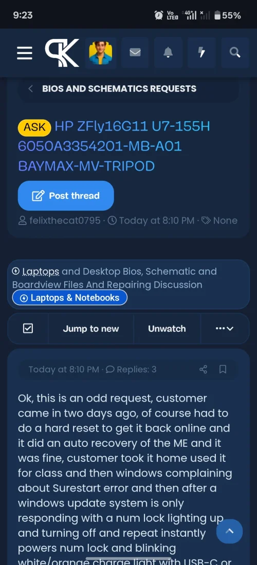

Ok, this is an odd request, customer came in two days ago, of course had to do a hard reset to get it back online and it did an auto recovery of the ME and it was fine, customer took it home used it for class and then windows complaining about Surestart error and then after a windows update system is only responding with a num lock lighting up and turning off and repeat instantly powers num lock and blinking white/orange charge light with USB-C or just battery.. Need to see if both Bios and EC can be repaired.
Model: HP ZFly16G11 U7-155H
Motherboard: 6050A3354201-MB-A01 BAYMAX-MV-TRIPOD
Serial: 2MQ4280DNR
Prod: A6UE4UT#ABA
Name: HP ZBook Firefly 16 inch G11
Hoping for the best. Thank you!

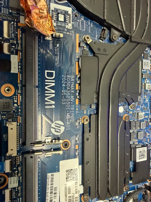

It's the correct board code sir. Thank you for the builds, which one is U320 you built?
See your board code in the picture
And write main bios in the chip that is nearby the ram and ec on the back side of the board
HP ZFly16G11 U7-155H 6050A3510501-MB-A01 BAYMAX-MV-TRIPOD – Screenshot_2026-04-02-21-23-26-18_40deb401b9ffe8e1df2f1cc5ba480b12
Damn it.... I'm so very sorry for that.
So the second U310 I uploaded isn't the EC on this board? U320 is where you said main is but U310 is next to TPM and battery on top of the board. Both are 25q256jwen.
