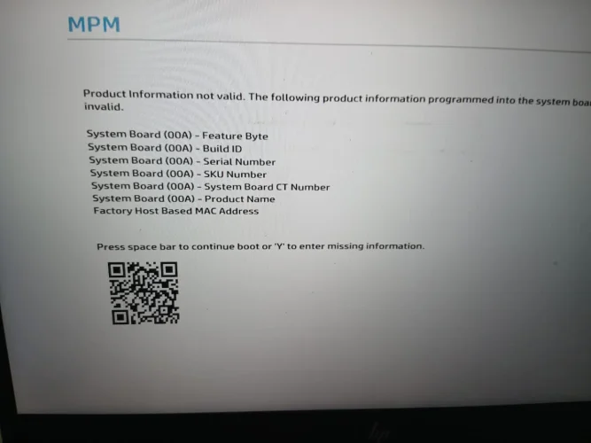

There is a bios file i got here that worked with your ec bios bin but there is a manufacture unlock mode message . can you fix it with my information , thank you .

This one no error.
You need add info after 34 time restart and done
