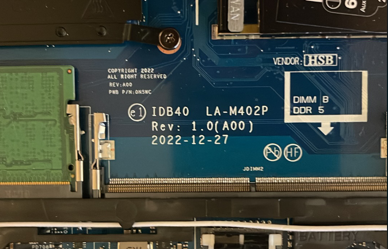

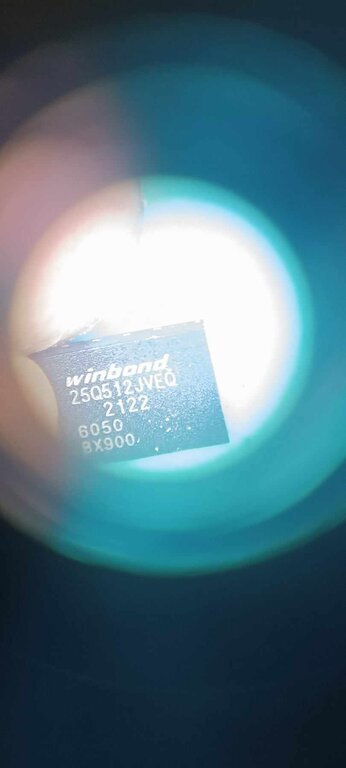

sir i ordered winbond chip w25q512 thd file that you give it turned on the unit but stock in dell logo can u help me sir thnxHere i build new
you need change bios chip winbond
W25Q512 Or
W25R512
Ill read now files then ican used w25q512?Yes read again bios chip and send will fixed
Ok sir tnx so much for your help, i as attqch my backupIf chip 25Q512 will not fixed hang in logo.
Use 25R512
Send me photo bios chip.Ok sir tnx so much for your help, i as attqch my backup
