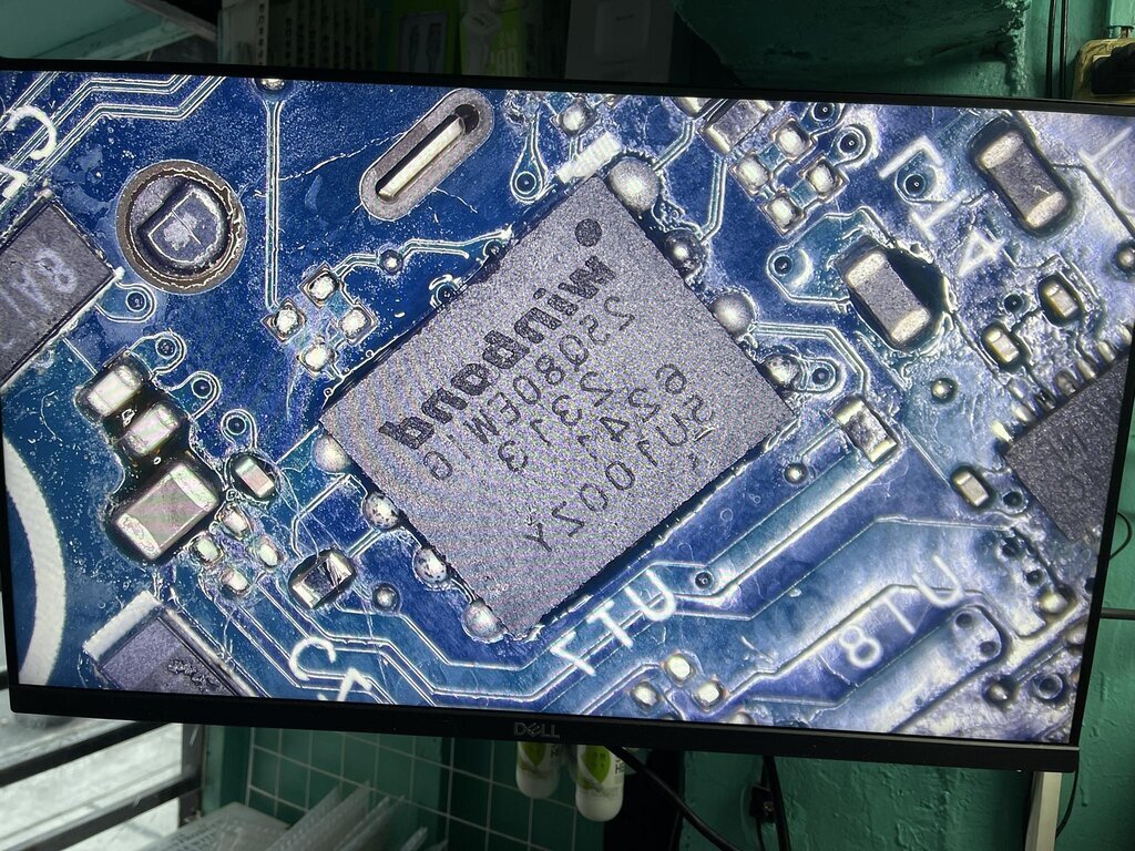

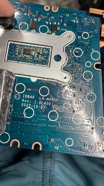

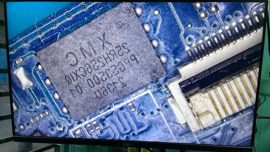

Dell latitude 5440 la-m402p rev 1.0(A00) mine is single cjip only the other chip i read is i think 1mb only , i attached the other chip i readData not good.Send board code
i think have 2 bios chip this model.
Send me photo bios chip.Dell latitude 5440 la-m402p rev 1.0(A00) mine is single cjip only the other chip i read is i think 1mb only , i attached the other chip i read
Send photo main chip.32mbBios chip atbthe back
25R512MEYIGI change the chip because the other busted
25R512MEYIG that isthe name of busted chip
