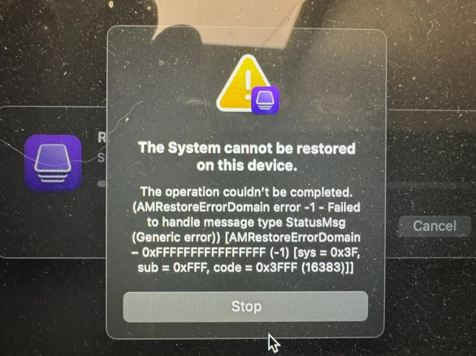

The old bin showed the error I do believe 4010. I would have to force it into DFU mode as it was stuck in recovery. The bin you all made worked perfectly as soon as I connected to the other mac it went directly into DFU mode without forcing it and it looked like it was going to work this time but then threw the error and when closed the error it went right into recovery. I'll check the board one last time maybe something fell off when it was stored with three other boards. But i may think after the very first time it booted and threw a fit about being a banned serial number when it was online, it may have corrupted the T2 to beyond repair.
