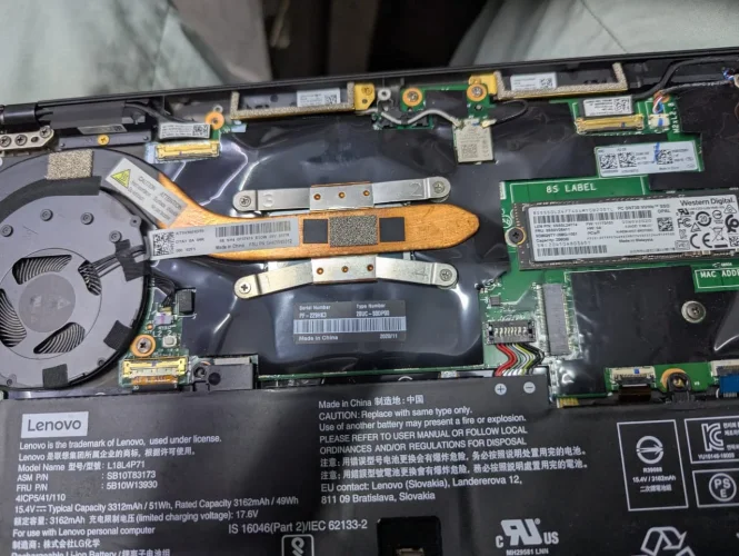

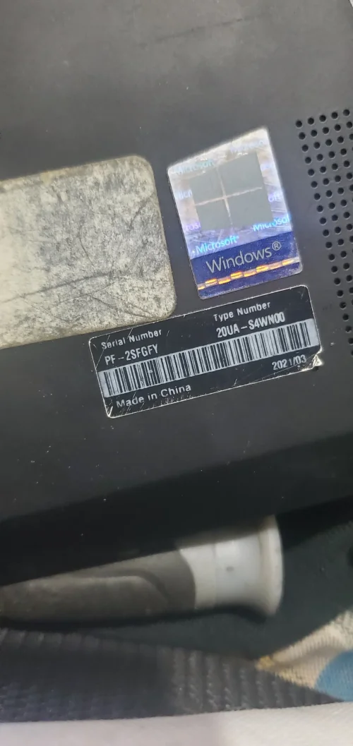

Hi, thanks for your reply. Unfortunately i havent found the dump i made before, i were sure its saved on my storage .. it is an X1Yoga Gen 5 with a I5-10310, attached you can find the specs and the S Nr. in the screenshot. meanwhile i flashed another bin from badcaps, one with a clean me. now i have a 3x blink of the power button LED after connecting the power supply, but after pushing the pw button still nothing happens. no cooler, no keyboard led - nothing. thanks for your help in advance !

Hi, thanks for your reply. unfortuntely i didn't found the dump i made.. i were sure to have it saved. it is a YOGYA X1 Gen5 with a I5-10310. i attached a screenshot here with all exact specs. meanwhile itred anoter bin from badcaps, a one with clean me. now i have a 3x blink of the power button LED after connecting the power supply with BIOS Battery and Accu already connected. then after pressing pw butt again nothing. thanks in advance !
