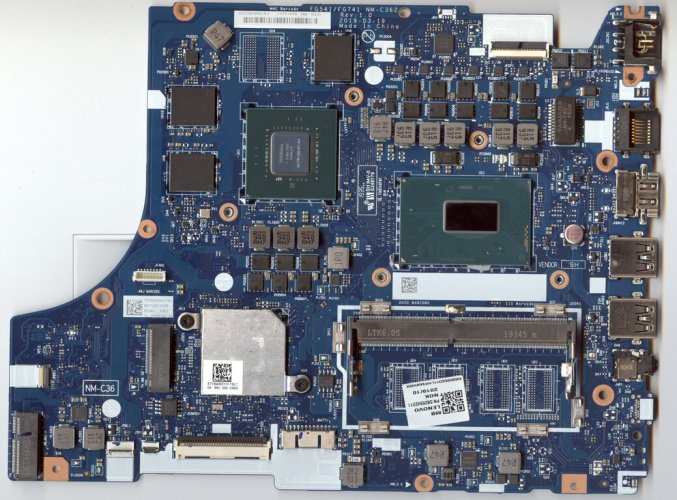

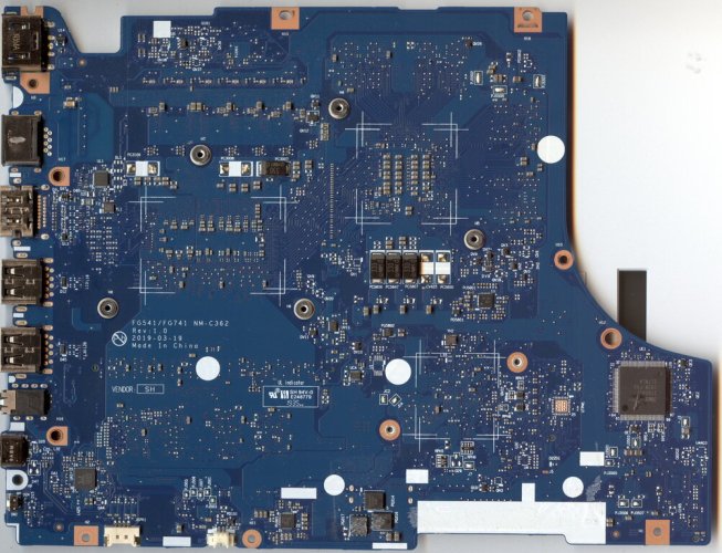

Scanned NM-C362 Rev: 1.0
The ITE chip is burned. :)
You can see it from the plane. :D
But that doesn't bother the picture. :D
Otherwise, it is a common problem with Lenovo when the DC connector is broken.
And when the ID pin touches the positive pin.
