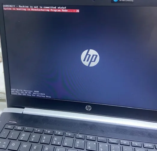

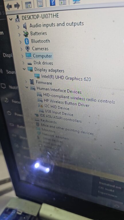

HP Probook 450 G5 DA0X8CMB6E0 BIOS X8C
COPY BIOS FROM WORKING LAPTOP WITH GPU
FIXED GPU NOT DETECT
BIOS Q85
BIOS Q85
