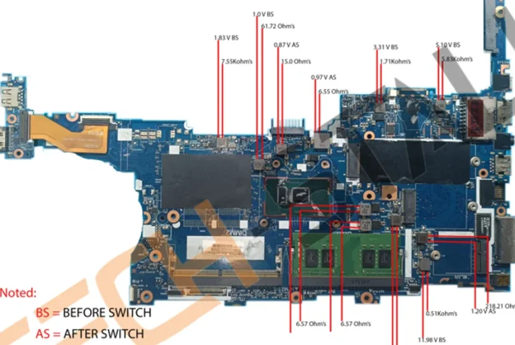

HP EliteBook 840 G3 Impedance Values — motherboard 6050A2892401-MB-A01.
If you have a working file for this board, please share it below. More files: search 6050A2892401-MB-A01 in File Finder.
HP EliteBook 840 G3 6050A2892401-MB-A01 Impedance Values – 1774379936785
840 G3 impedence value.rar

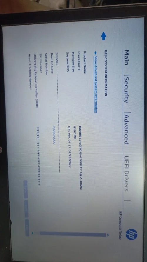

probe el archvo no hay datos dmi ayuda nuevamente
write bios that have no information and you"ll see mpm error then go into bios in advance check machine unique data and insert all the information from txt file and press f10 to save changes. All set
info.txt
