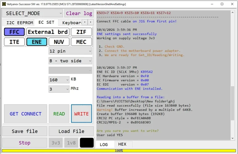

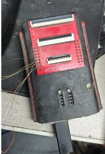

LA-K472P KB_pins=12 RIGHT DOWN 05MM KSO3=7 KSI4=9 KSI7=12 KSI6=11 KSI5=10 FLASH=160
KB9542GF
KS03:H13 PIN 7 SUCCESSOR SOCKET
KSI4: D13 PIN 9 SUCCESSOR SOCKET
KSI7:E10 PIN 12 SUCCESSOR SOCKET
KSI6:C13 PIN 11 SUCCESSOR SOCKET
KSI5:C12 PIN 10 SUCCESSOR SOCKET
Alienware M17 R3 LA-J521P BIOS
KB9542GF
LOCATION​
