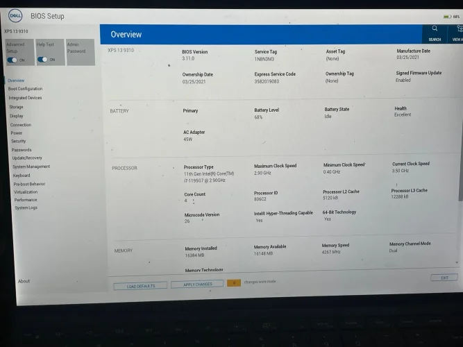

Hello everyone, I i have XPS 9310 LA-J144P Rev 2. The unit before was doing loops on logo. I've flashed this file from many, and it's the only one that worked. For some reason, this particular unit and LA-L882 they have issues for not detecting SSD...
This file works after couple of reboots but takes me to BIOS GUI. NO SSD Detected, and the issue isn't the hardware, it's the BIOS file itself. Good is the file that i got from somewhere online...Bad is the original file. Thanks!
Note: The good file has slow boot and sometimes it restarts few times before accessing the BIOS. I tried also your file above, and it didn't work.

Hello, with your file the unit hangs on logo for 45 seconds then reboots and hangs again.
This file the machine stays on stuck at the dell logo. Thanks
