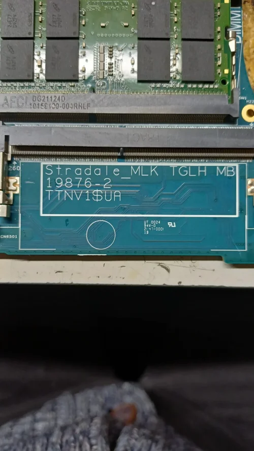

This BIOS is freezing. The old BIOS file freezes at the Dell logo. I exported the file and checked it with a hex editor, but the contents aren't fully populated. I'm sharing it. I tried this file, and it still freezes at the Dell logo. It gives a 3 orange 6 white light error. Are there any other BIOS dumps I can try?

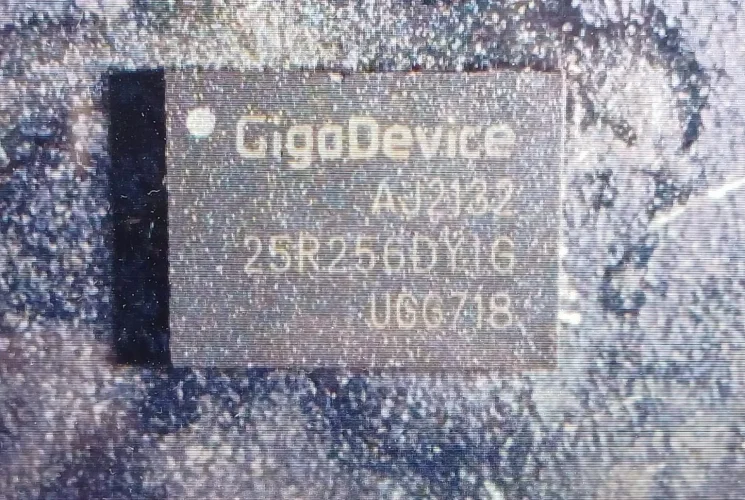

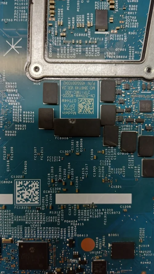

Okay provide serial number and upload a clear picture of bios chip

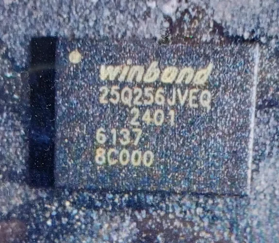

The old BIOS chip is from Gigadevice. I couldn't fully see its contents with the hex editor. I replaced it with a new Winbond chip. It has Winbond installed.

Dont replace bios chip use the above tested okay bios write in GigaDevice 25R256 and check
I wrote. It freezes on the Dell logo. I can access the BIOS settings using Winbond and a BIOS I obtained from a different site, but it freezes on the boot screen. I need a BIOS version that hasn't been clean me region, model 19876-2.
