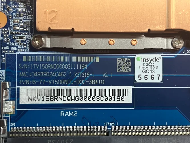

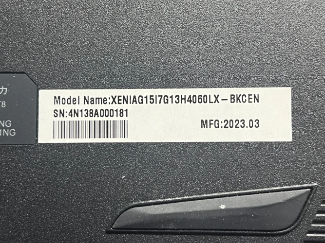

Hi, I have a xenia 15g with no display and only the fans spinning after programming the BIOS with a bin file from the manufacturer's site. After flashing the original BIOS back, I'm still having the same no display and fans spinning issue. I'm not sure what to do at this point but I'm attaching the original bin file and the site's BIOS files and hoping you can help me with this.
A-DATA XPG XENIA 15G
6-71-V15R0-D02
V150RNEMB-OD
SRMJ1 (Intel Core i7-13700H)
BIOS Chip GD25B256E@WSON8
SN: 4N138A000181
This thread is for the A-DATA XPG XENIA 15G Corrupted.
Compare the board number printed on the PCB (near the RAM slots or under the battery) with the files before you flash.
BOARD: 6-71-V15R0-D02
CLEAN ME BIOS
CSME Version: 16.1.27.2225
File System Stage: Configured
FACTORY IMAGE
V15xRNX FACTORY IMAGE.rar
You guys are awesome! BIOS is working. Any way I can get DMI info on there? Missing SN and MAC address.
